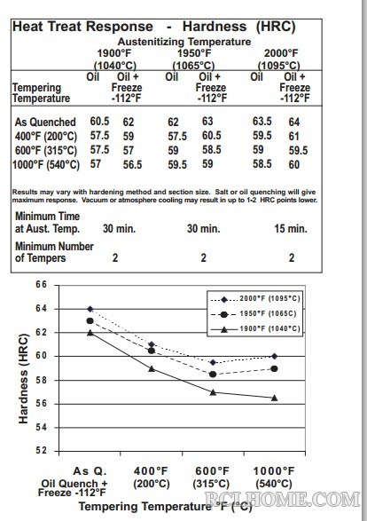

热处理数据
Preheat:  Heat to 1550-1600°F (845-870°C) Equalize.
Austenitize: 1900-2000°F (1035-1095°C), hold time at temperature 15-30 minutes.
Quench: Air or positive pressure quench (2 bar minimum) to
below 125°F (50°C), or salt or interrupted oil quench to about
1000°F (540°C), then air cool to below 125°F (50°C).
Temper:  Double temper at 400-750°F (200-400°C).  Hold for
2 hours minimum each time.  (See Table)  A freezing treatment
may be used between the first and second tempers.  Freezing
treatments help to attain maximum hardenability and must
always be followed by at least one temper.
NOTE: For optimum stress relieving, CPM S35VN may be tempered
at 1000-1025°F (540-550°C).  Tempering in this range may
result in a slight decrease in corrosion resistance.
Recommended Heat Treatment:
Austenitize 1950°F (1065°C).  Quench to below 125°F (50°C).
Double temper at 600°F (315°C) 2 hrs. minimum each temper.
Cool to hand warm between tempers.  A freezing treatment may
be added between tempers.
Aim hardness:  58-61 HRC.
