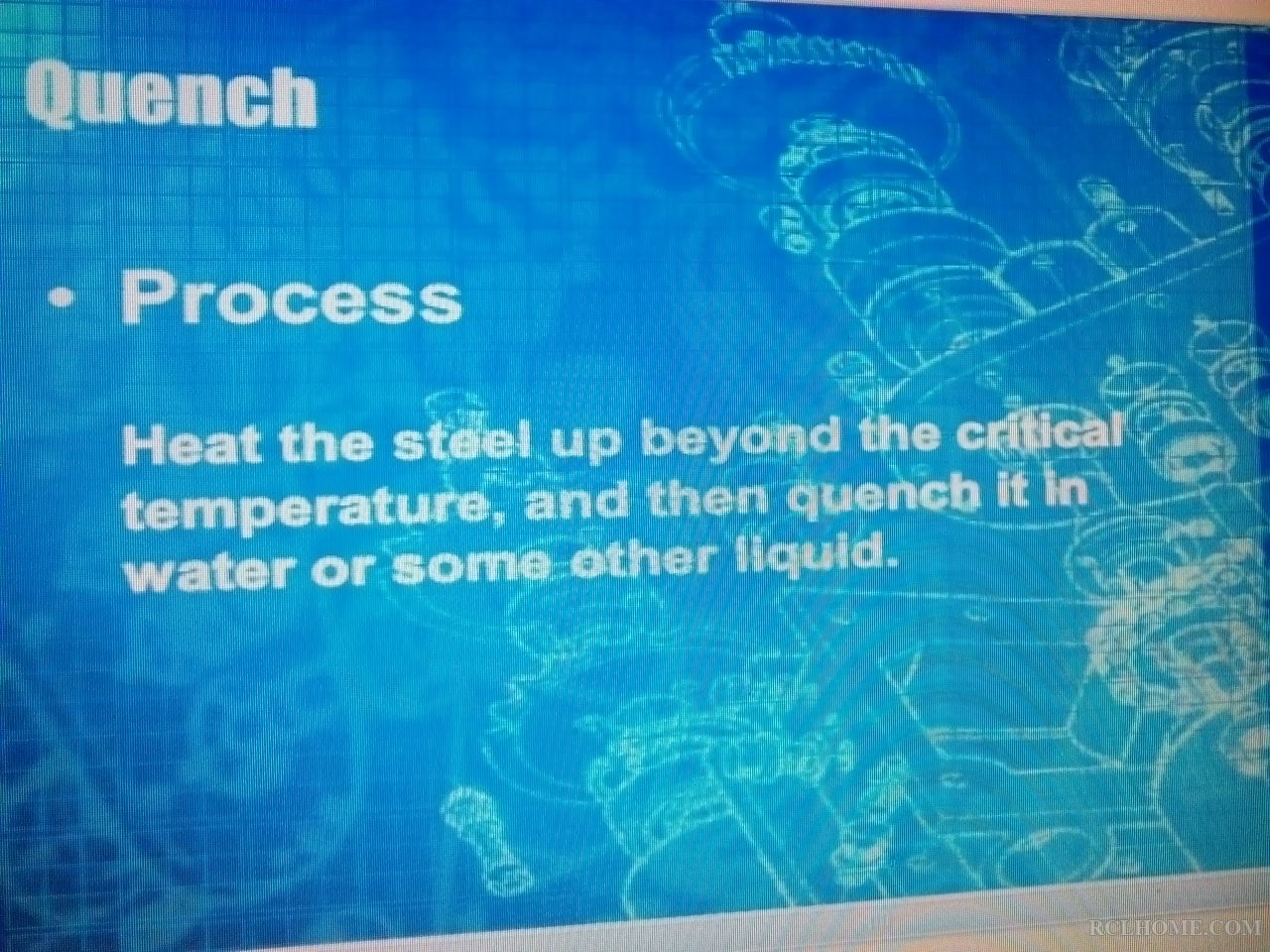

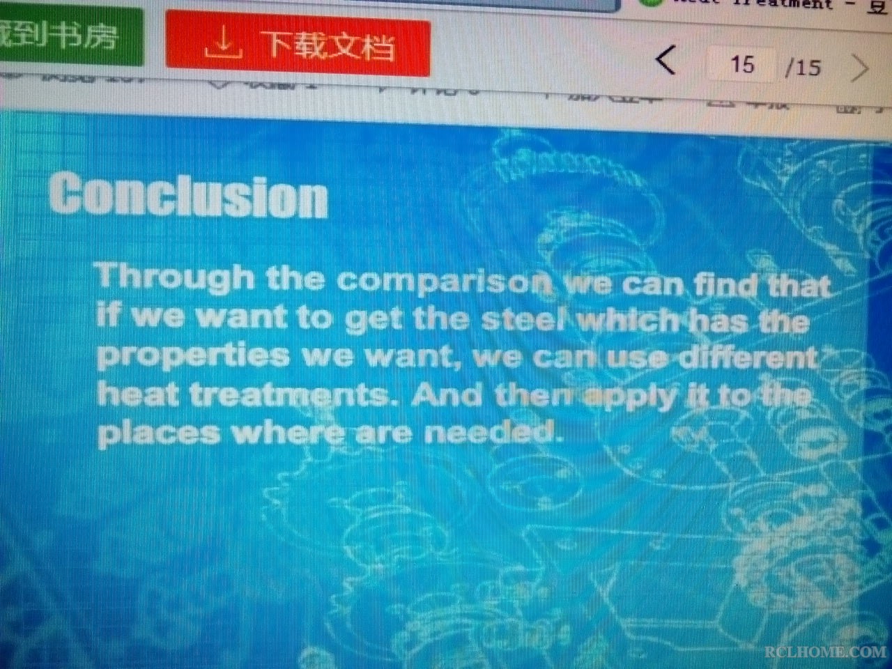

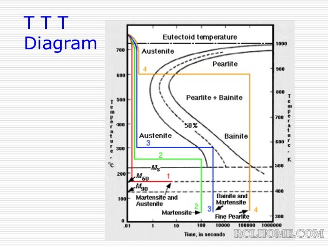

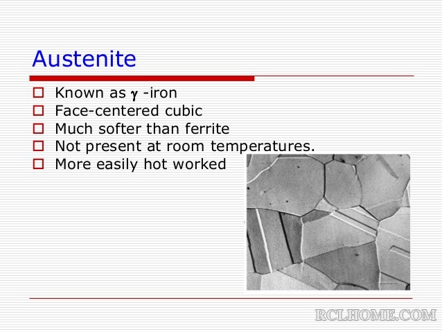

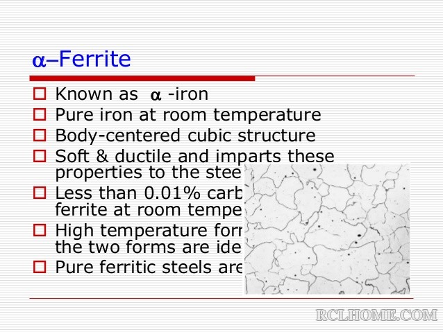

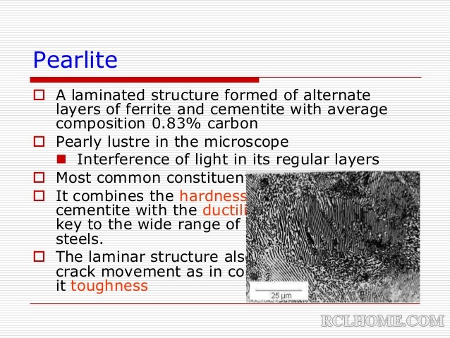

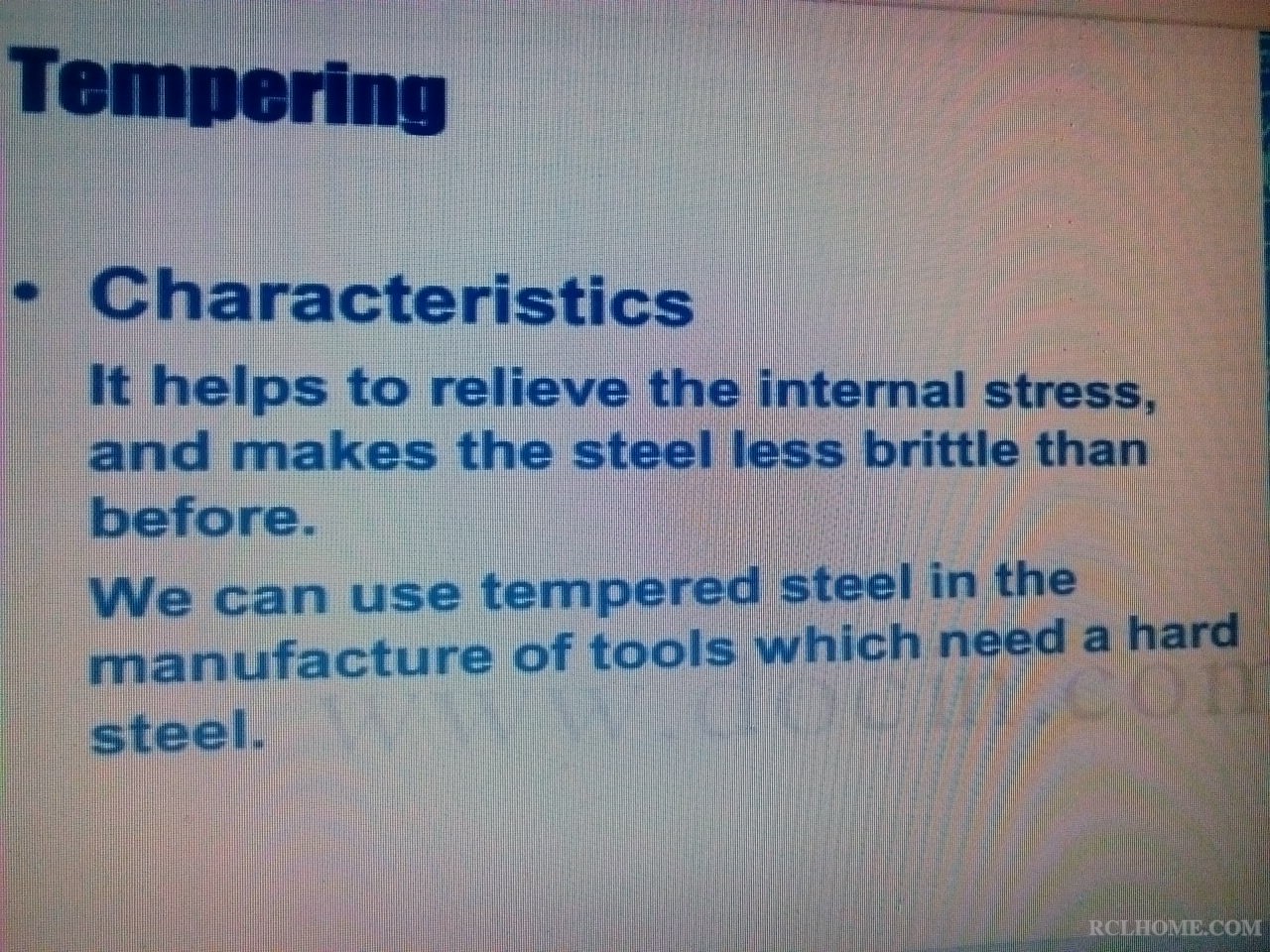

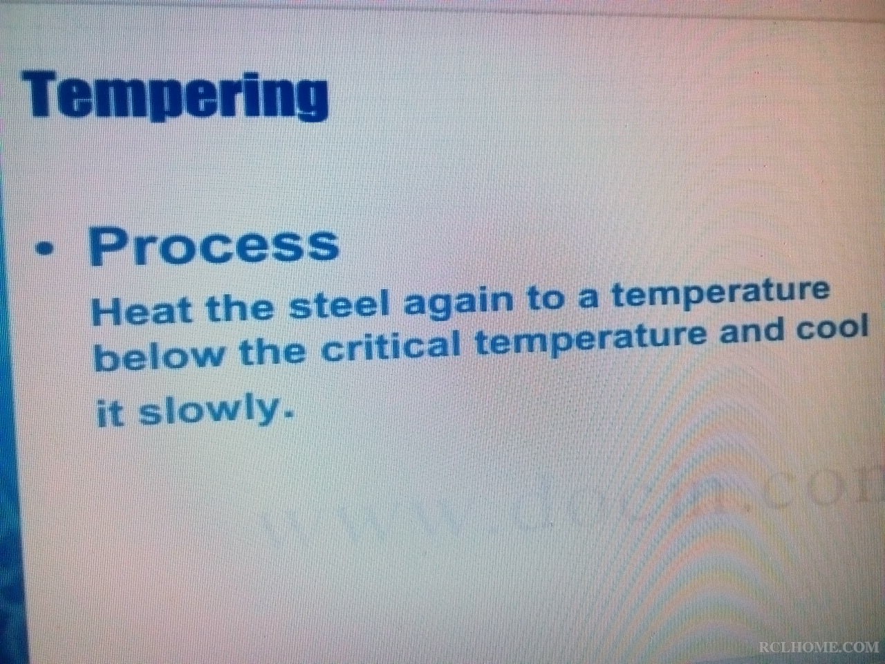

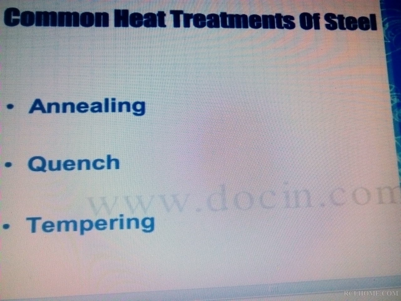

IMG_20141213_185015.jpg IMG_20141213_185033.jpg IMG_20141213_185047.jpg IMG_20141213_185105.jpg IMG_20141213_185117.jpg IMG_20141213_185132.jpg IMG_20141213_185143.jpg IMG_20141213_185155.jpg IMG_20141213_185206.jpg IMG_20141213_185215.jpg IMG_20141213_185223.jpg IMG_20141213_185233.jpg IMG_20141213_185241.jpg IMG_20141213_185303.jpg IMG_20141213_185314.jpg

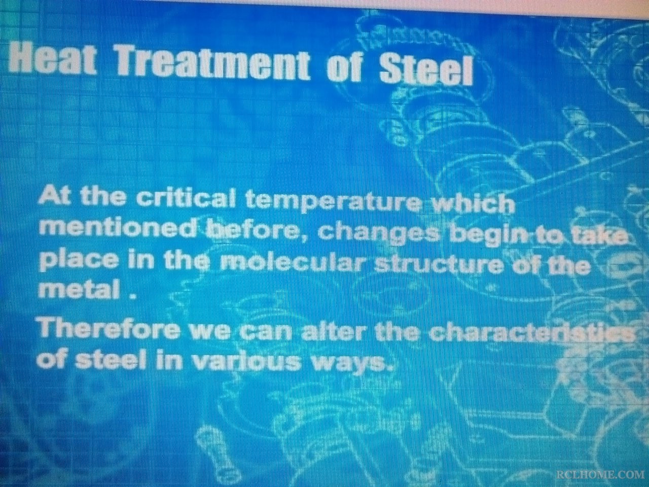

5. Heat Treatment Definition• Any thermal treatment to alter the existing mechanical properties of a metal or alloy. - Increase strength – harden the material. - Decrease strength – soften the material. - Through harden or surface harden a material. - Toughen the material-tempering. - Stress relieve to remove residual stress. - Intermediate anneals after cold working to soften the material or for grain refinement. - Pre-heating or post-heating for welding processes. Heat Treating 5

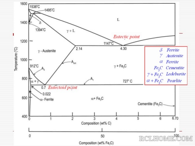

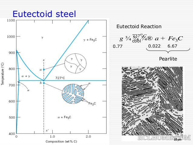

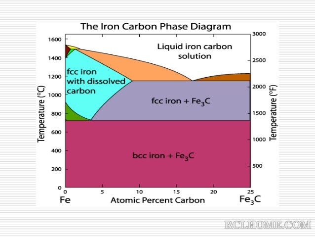

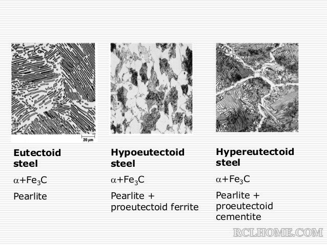

6. Iron-Carbon Phase Diagram Heat Treating 6
7. Iron-Carbon Phase Diagram Heat Treating 7

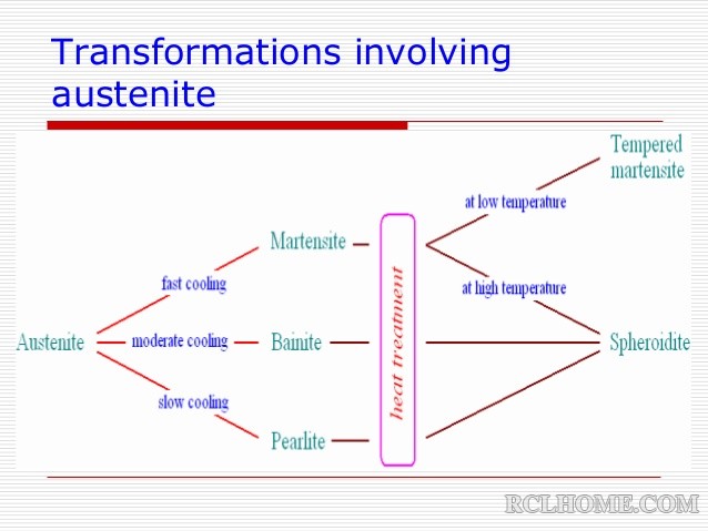

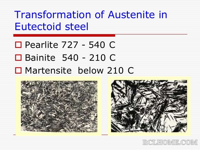

8. Hardenability of Steels• The ability to harden or strengthen a steel through heat treatment by quenching from the upper critical temperature to: - Form martensite. - Form bainite. - Quenching is a rapid cool from the upper critical temperature intended to miss the nose of the time-temperature-transformation curve.• Hardenability is measured as the distance below the surface where: - The metal exhibits a specific hardness. - The microstructure contains 50% martensite.• Hardenability varies as a function of: - Carbon content. - Manganese content. - Other elements such as chromium, nickel and molybdenum. - Quench media and cooling rate. Heat Treating 8

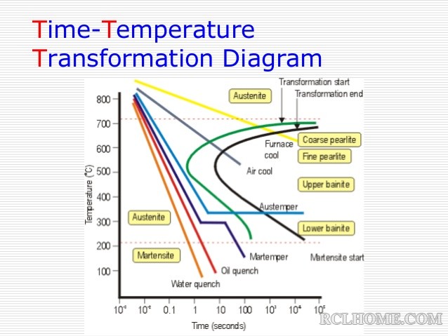

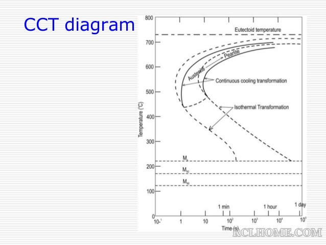

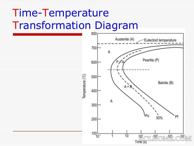

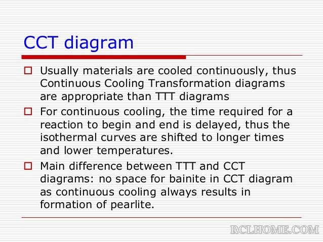

9. Hardening Steels by Quenching and Tempering• Time-Temperature Transformation Diagram: Heat Treating 9
10. Quench and Tempering to Strengthen Steel• Quench and temper to form martensite-the strongest possible structure in steels. - Austenizing, at a temperature above A3, transforms the bcc structure to fcc. Ferrite and pearlite are dissolved to form austenite. - Rapidly quenching to below the Ms temperature starts to form martensite. Cool to below MF to allow complete transformation to martensite. - Martensite formation is a diffusionless transformation. The structure is tetragonal and forms rapidly. - Complete transformation requires cooling through the transformation temperature range, to below MF. The resulting martensite is brittle and called untempered martensite. - Tempering is a process of reheating to a low temperature to toughen the steel.• Quenching can be in oil, plain water, salt water, polymers, salt baths, or air depending on the composition or alloy content of the steel. - Carbon steels will almost always require a water quench to form martensite. - Alloy steels are usually quenched in oil, polymers or salt baths. - Some tool steels harden by cooling in still or agitated air. Heat Treating 10
11. Martempering to Strengthen Steel• Martempering, or marquenching, is a variation of the quench and temper and consists of austenizing, quenching and tempering. - The quench is interrupted to hold the part(s) just above the Ms temperature to allow parts to equalize in temperature. This reduces stress and distortion. The parts are then quenched below Ms to form martensite. - Tempering is necessary to toughen the martensite. Heat Treating 11
12. Martempering Transformation Diagram Heat Treating 12

15. Austempering to Strengthen Steel• Austempering forms bainite instead of martensite. - Bainite is a slow isothermal transformation from austenite. - Bainite has increased ductility and toughness at the same strength levels as martensite. - Bainite has reduced distortion and residual stress which lowers subsequent processing costs. - Austempering provides the shortest cycle time to through-harden within the hardness range of Rockwell C 35-55 HRC. - Not all steels can be austempered.• Austempering consists of the following processing steps. - Heating to a temperature above A3 to transform the microstructure to austenite. - Quenching to a temperature above the Ms temperature and holding for a period of time to transform the austenite to bainite. - No tempering is required.• Steels for austempering: - Plain carbon steels with carbon between 0.50-1.00%, and manganese ≥ 0.60%. - Carbon steels with manganese ≥ 1.00% and carbon slightly less than 0.50%. - Alloy steels with carbon ≥ 0.30% such as 5100 series. - Alloy steels with carbon ≥ 0.40% such as 1300 to 4000 series and 4140, 6145, 9440. Heat Treating 15
16. Austempering Transformation Diagram Heat Treating 16

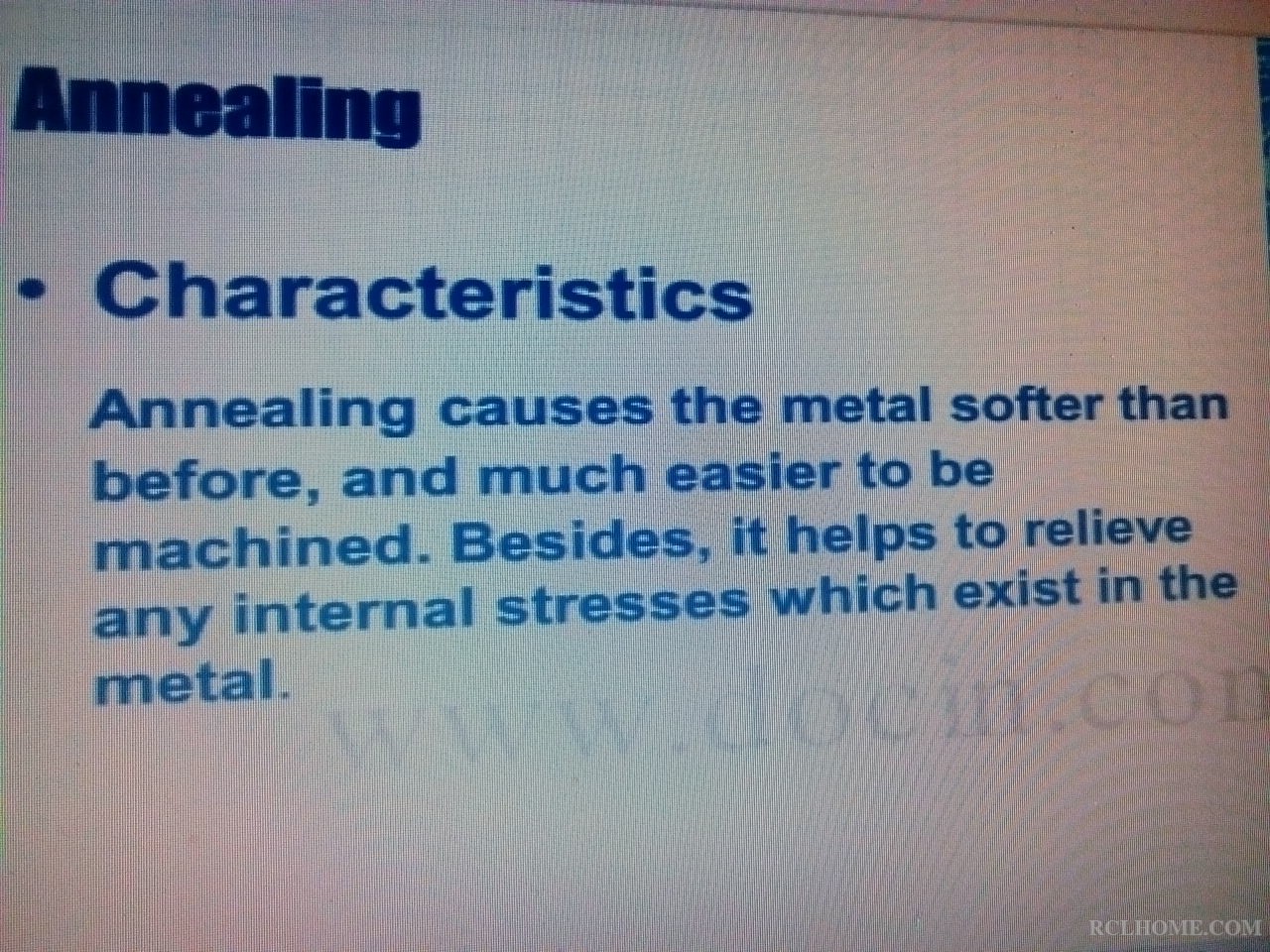

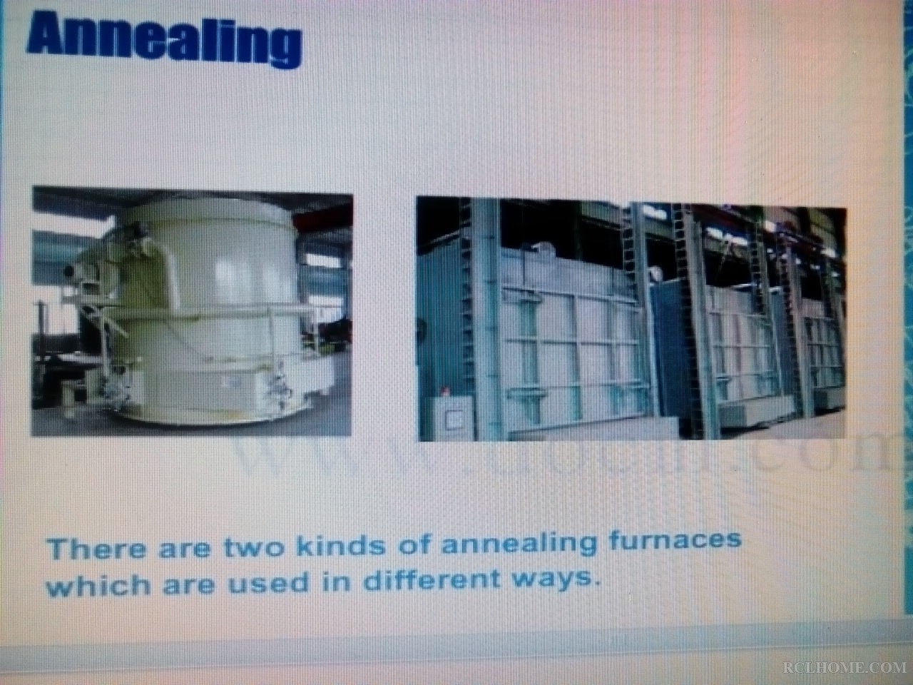

31. Heat Treatments to Soften Steel• Annealing – A generic term to describe the heating, holding and cooling at appropriate rates to soften steel. - Cooling occurs in the furnace at slow controlled rates. - Yields a coarse ferrite-pearlite-cementite structure. - Facilitates machining and cold working. - Relieves residual stress. - Variations are full anneal, spherodize anneal, and process anneal. - An annealed steel, or other alloy, is at its minimum mechanical properties.• Normalizing – An austenizing heat treatment followed by controlled cooling in still or agitated air. - The part must be heated above the critical A3 temperature. - Used to refine grain structure, improve machineability, reduce residual stress, and homogenize the structure. Heat Treating 31
32. T-T-T Diagram for Annealing Steel Heat Treating 32
33. Annealed Steel Annealed SAE 1144 – 100X Annealed SAE 1144 – 500X Heat Treating 33

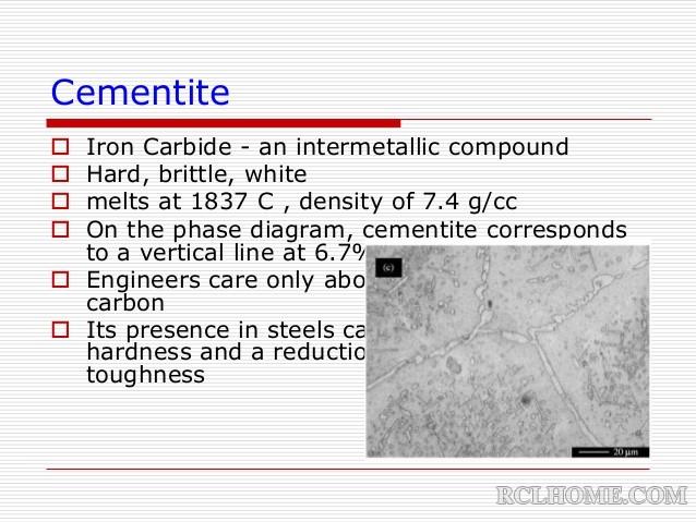

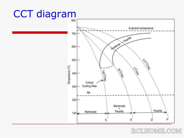

iron-carbon-phase-diagram-36-638.jpg iron-carbon-phase-diagram-9-638.jpg iron-carbon-phase-diagram-12-638.jpg iron-carbon-phase-diagram-13-638.jpg iron-carbon-phase-diagram-14-638.jpg iron-carbon-phase-diagram-16-638.jpg iron-carbon-phase-diagram-17-638.jpg iron-carbon-phase-diagram-18-638.jpg iron-carbon-phase-diagram-19-638.jpg iron-carbon-phase-diagram-20-638.jpg iron-carbon-phase-diagram-21-638.jpg iron-carbon-phase-diagram-22-638.jpg iron-carbon-phase-diagram-23-638.jpg iron-carbon-phase-diagram-24-638.jpg iron-carbon-phase-diagram-25-638.jpg iron-carbon-phase-diagram-26-638.jpg iron-carbon-phase-diagram-27-638.jpg iron-carbon-phase-diagram-28-638.jpg iron-carbon-phase-diagram-29-638.jpg iron-carbon-phase-diagram-30-638.jpg iron-carbon-phase-diagram-31-638.jpg iron-carbon-phase-diagram-32-638.jpg iron-carbon-phase-diagram-33-638.jpg iron-carbon-phase-diagram-34-638.jpg iron-carbon-phase-diagram-35-638.jpg hypoeutectoid steel亚共析钢,hypereutectoid steel过共析钢  eutectoid steel 共析钢
