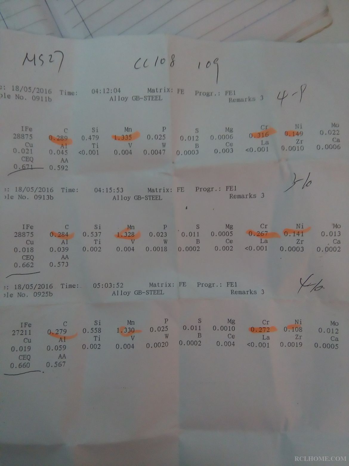

MS27材质试棒,正火硬度193,195HBW,500℃回火后,硬度反而提高到201,207HBW,费解
