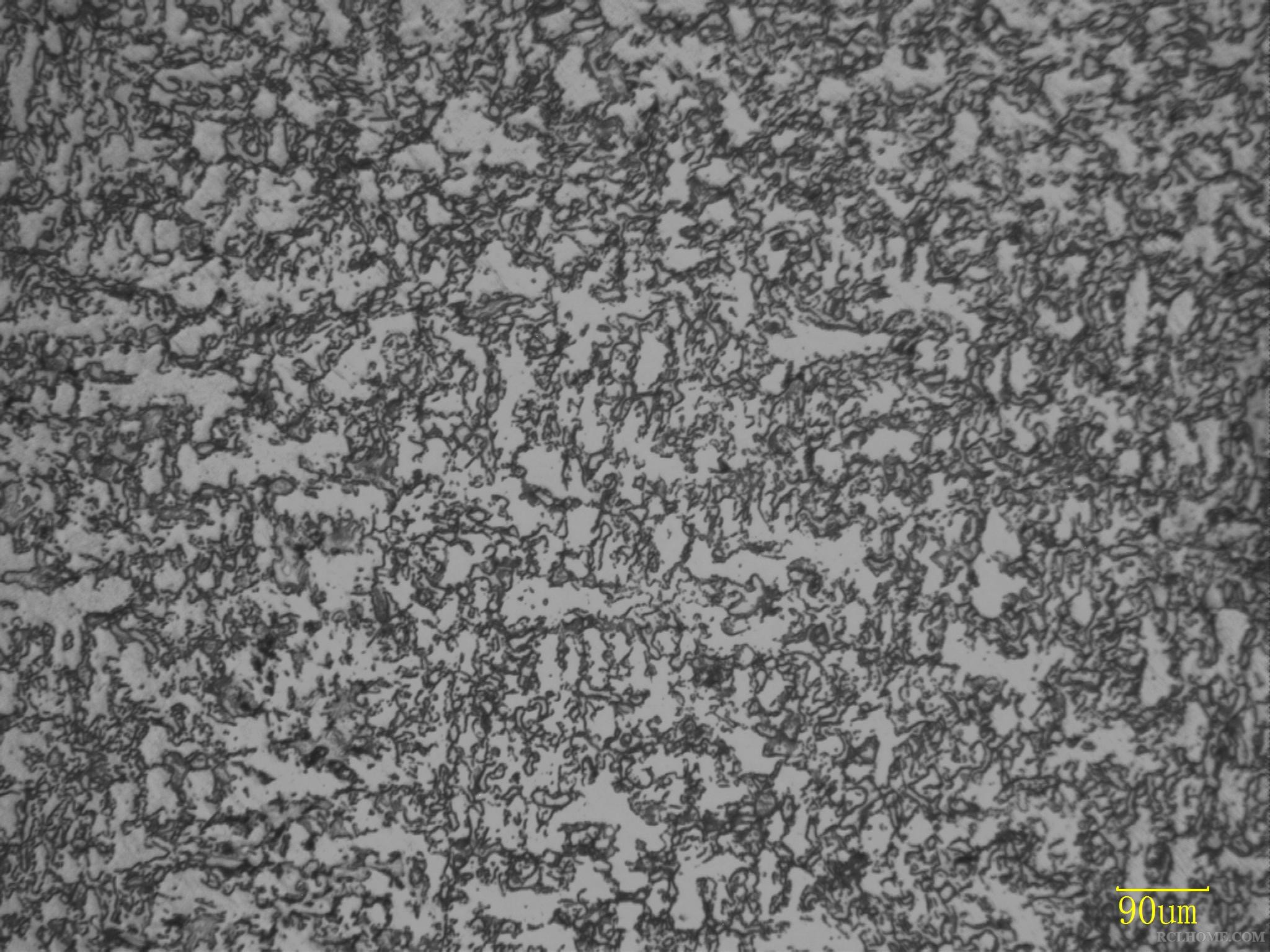

金相要求:
The microstructure of material made to this specification shall consist of a network of
chromium carbides plus some globular manganese sulfides dispersed in a matrix of
chromium ferrite.
化学成分:
Element Min (%) Max (%)
Carbon 0.30 0.60
Silicon 1.80 2.20
Manganese -- 1.50
Sulfur 0.10 0.30
Phosphorus -- 0.06
Chromium 18.00 21.00
Nickel -- 0.50
Titanium -- 0.08
Other Elements Tested (each) -- 0.30
Iron Balance

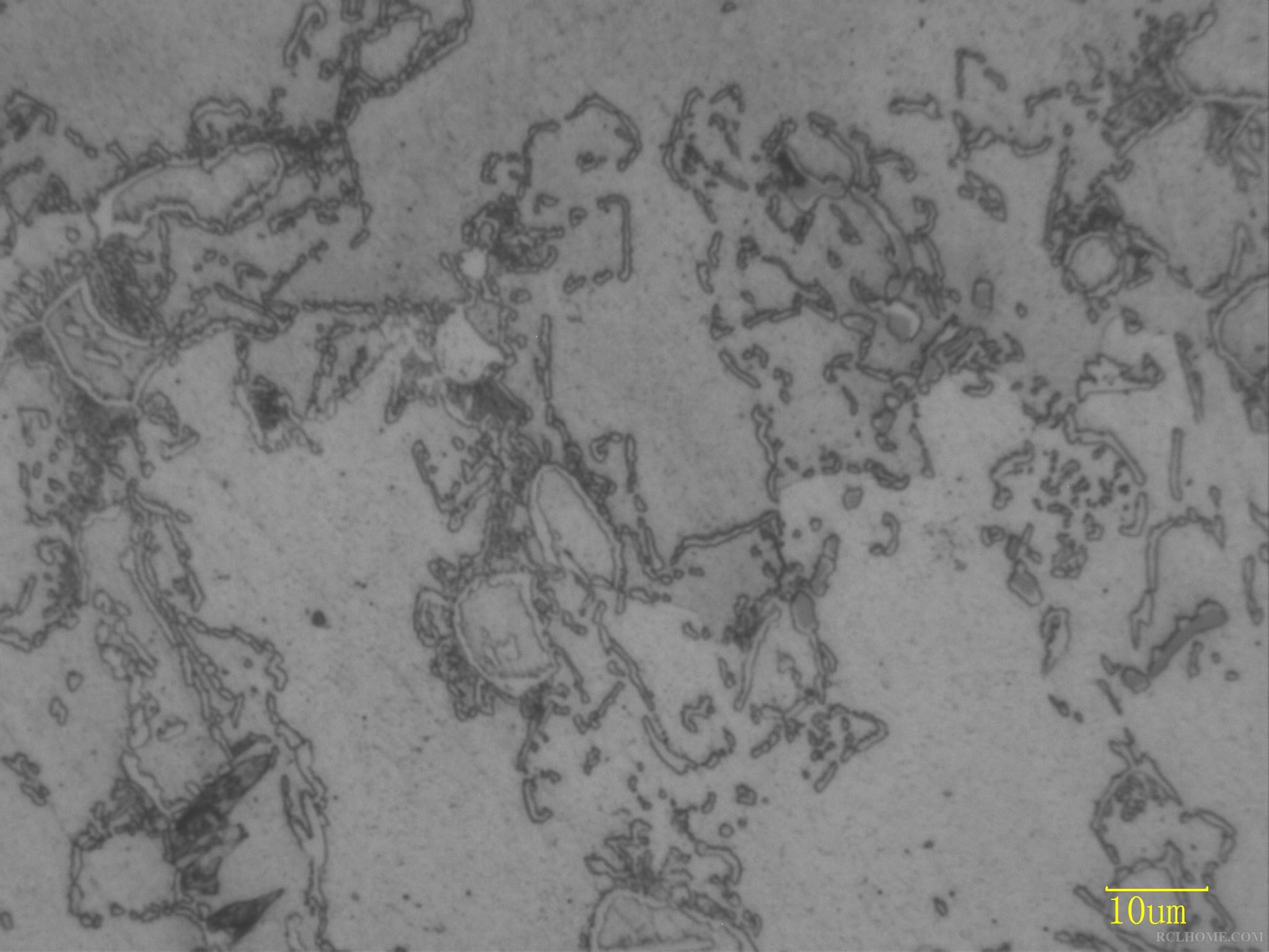

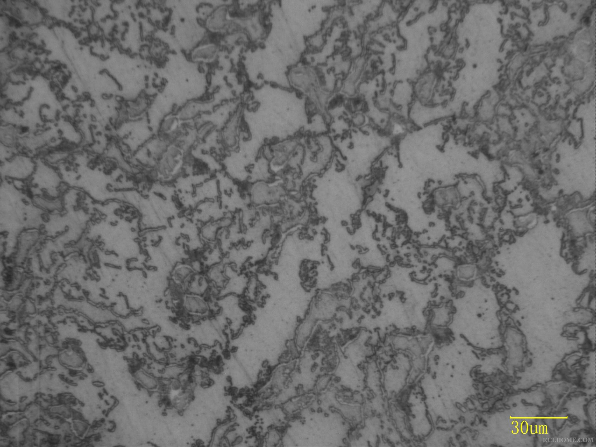

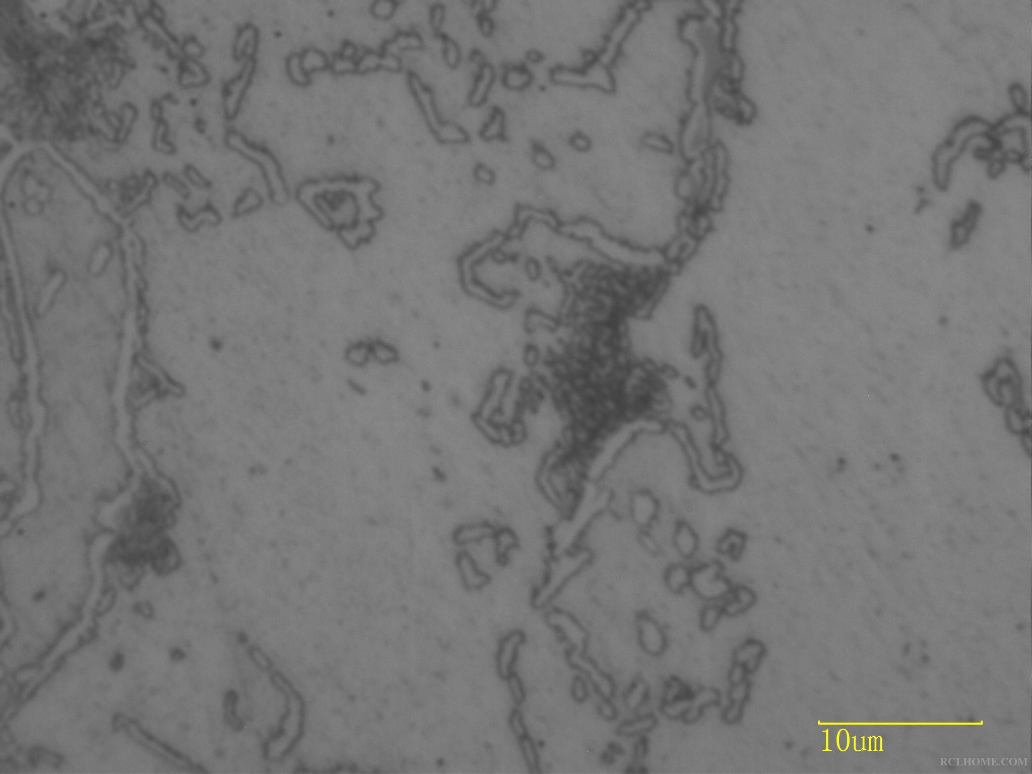

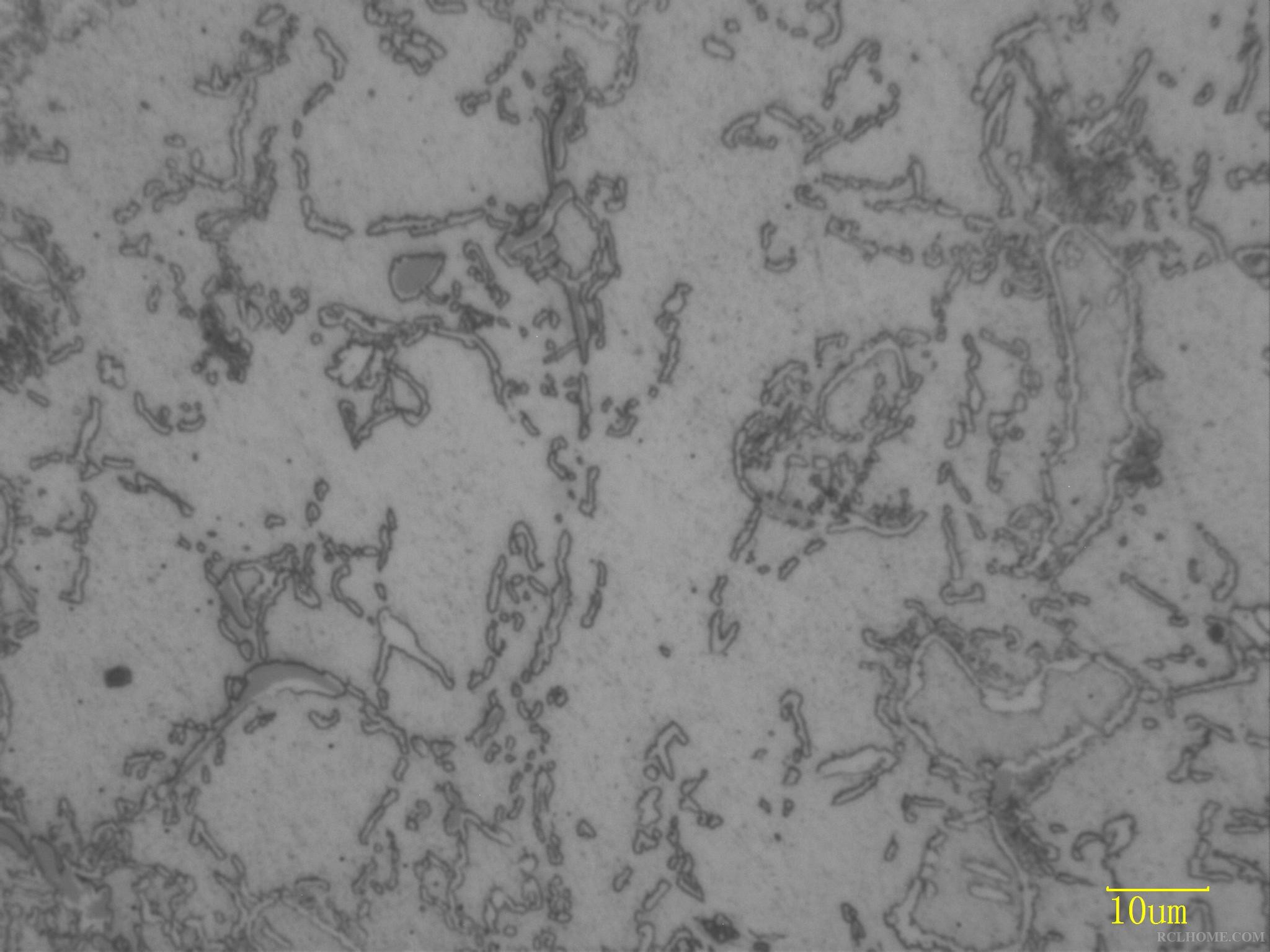

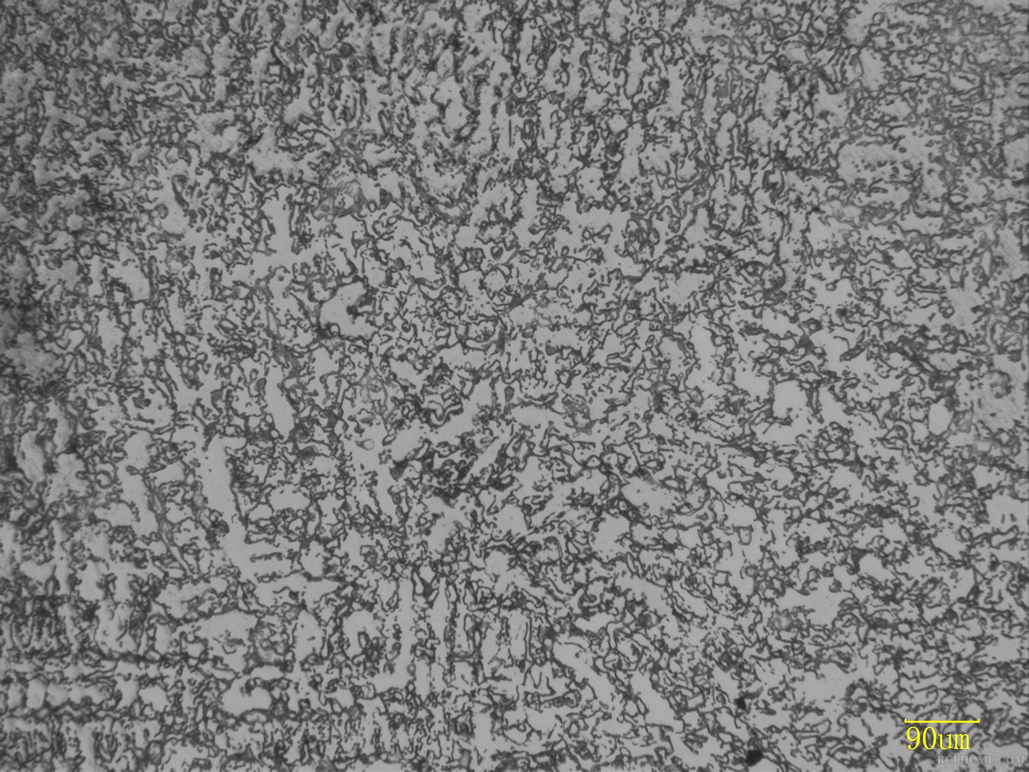

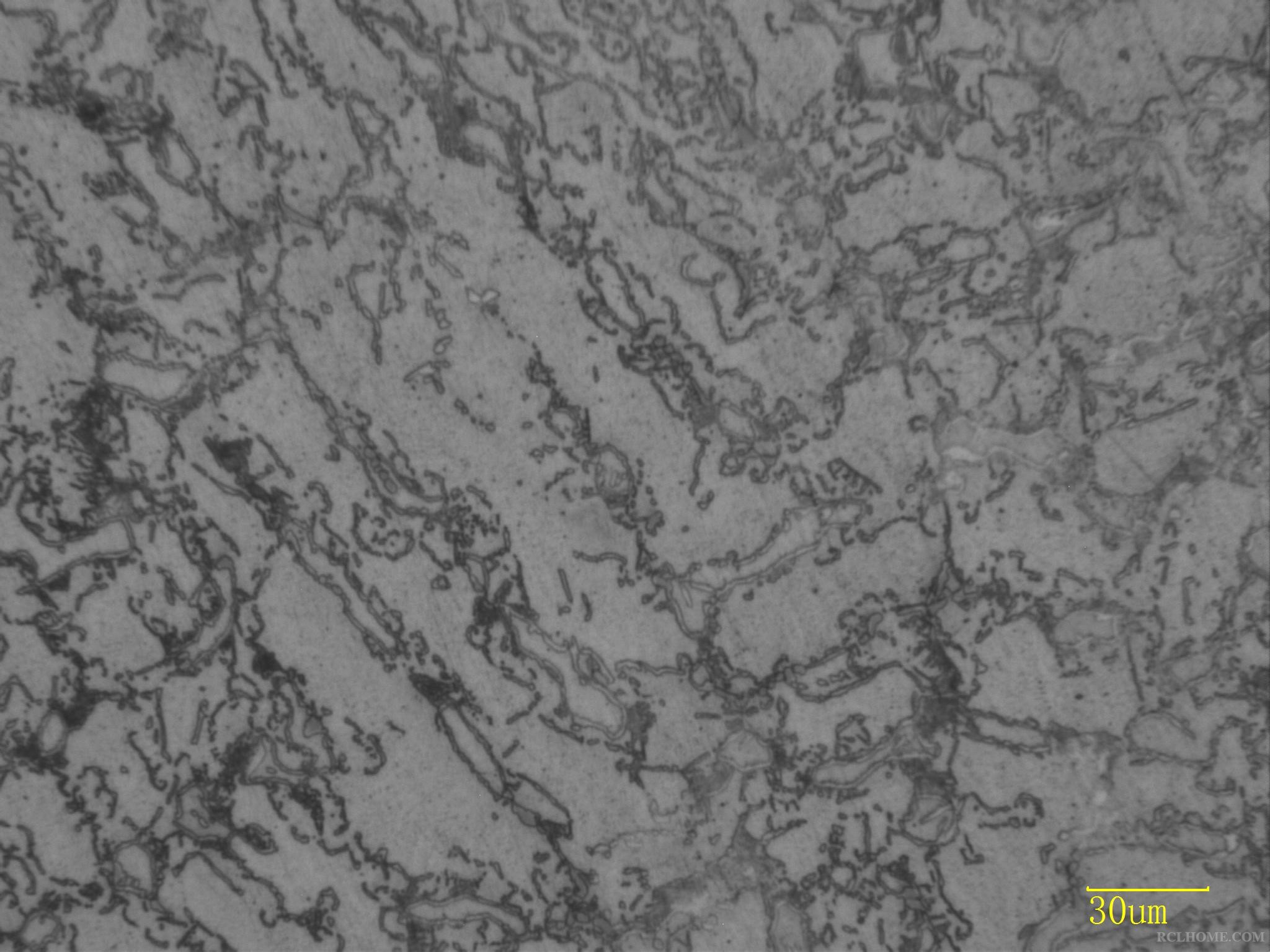

腐蚀后图片,如下

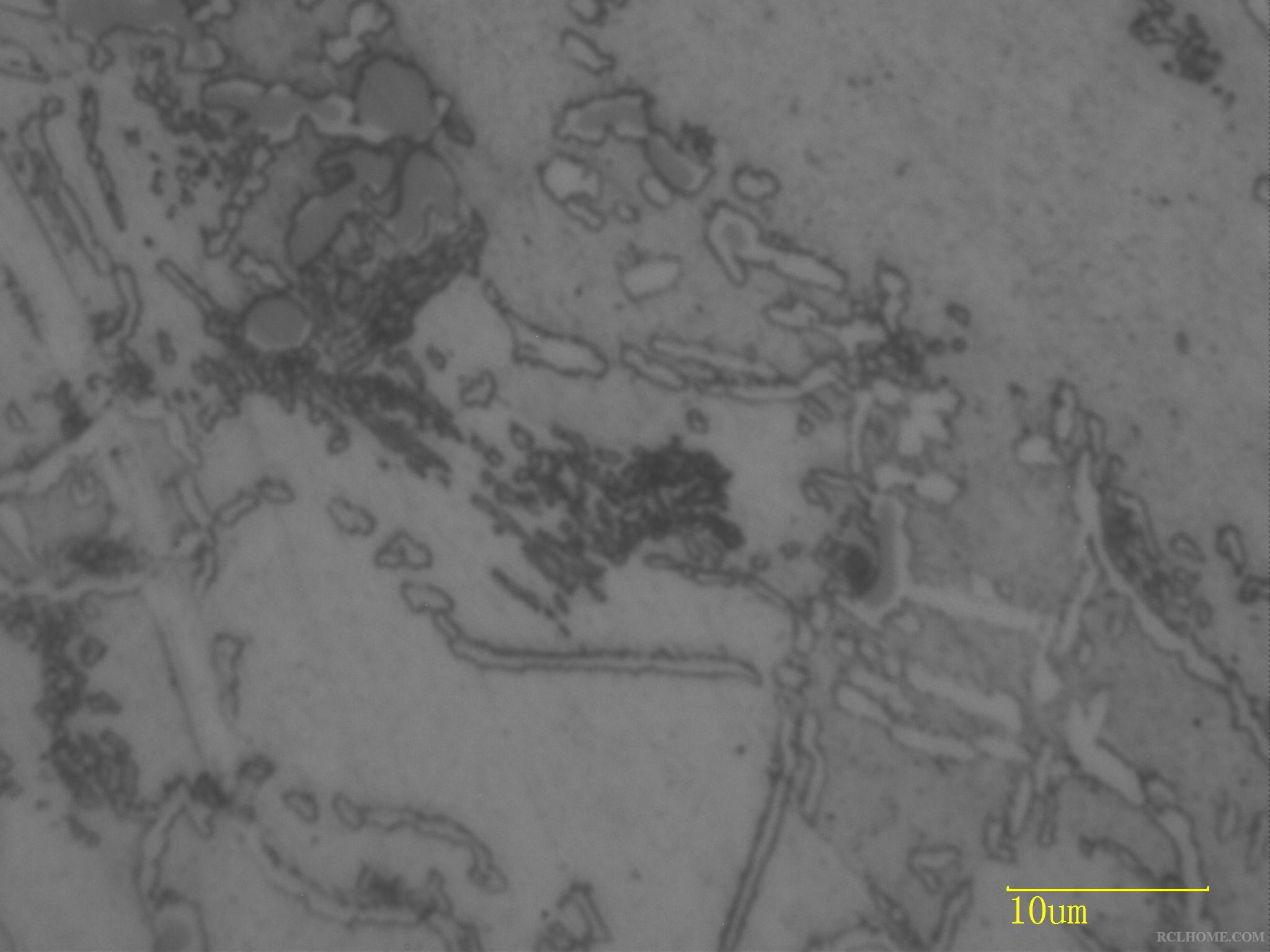

1000x图片上面,碳化物里面是什么析出的,怎么一张上面有,一边没有啊

再发张不要腐蚀的金相照片,那样可以看下硫化锰形态
