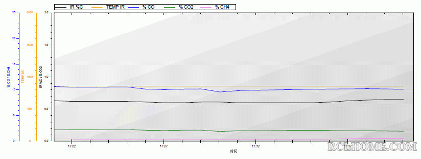

发表于 2013-11-12 08:09:40 | 显示全部楼层
SKF建议用如下气氛:
As discussed, 3 gas analysis is required for your new salt bath furnace, the recommended CO content is around 10%.
Your furnace atmosphere is N2+CH3OH+C3H8 and pls keep appropriate atmosphere flow rate with at least 5% tolerance for each one.
吉祥如意 + 10
